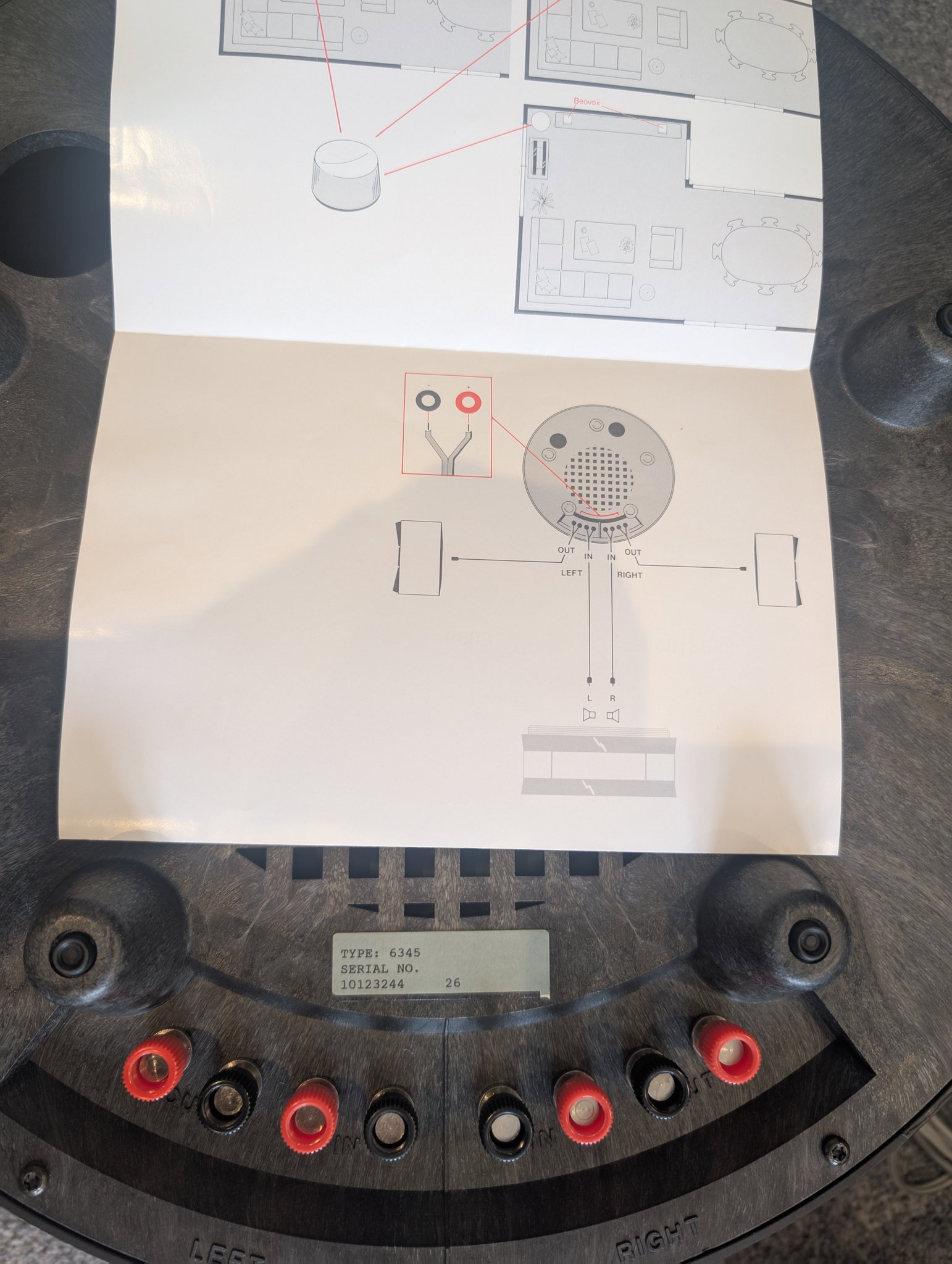

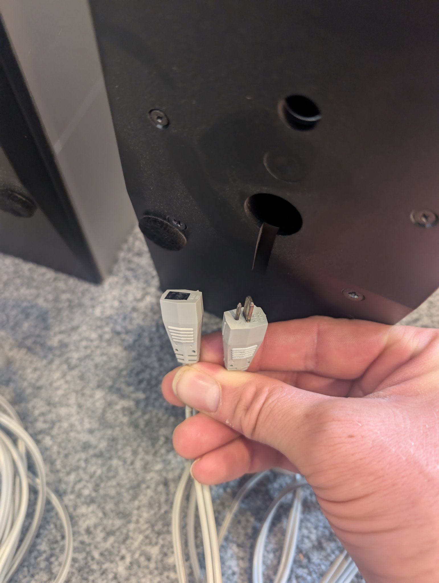

Hi all, I have a full beosystem 6500 alongside the Beovox CX100 speakers, and Beovox Cona subwoofer, but I cannot for the life of me work out how you are supposed to connect inline, the DIN cabled CX100 speakers with the input/output connections on the underbelly of the Cona subwoofer which require raw copper cable, any help would be massively appreciated and even a cuppa of coffee donation would go to the first individual that helps me crack the solution, thanks for any support
Hi Benji, Your cabling can be as follows: Din plugs (male) from speaker output 1 on Beomaster to bare wire. Bare wire to input shown on Cona (ensure correct polarity). A second run of cable is required to allow bare wire from Cona outputs to Beovox. If the Beovox have male DIN then use the female sockets. In short, if the cable you have is long enough, visualise your final placement and cut the cable. The Cona will sit between the Beomaster and the Beovoxes acting a bit like a crossover.
