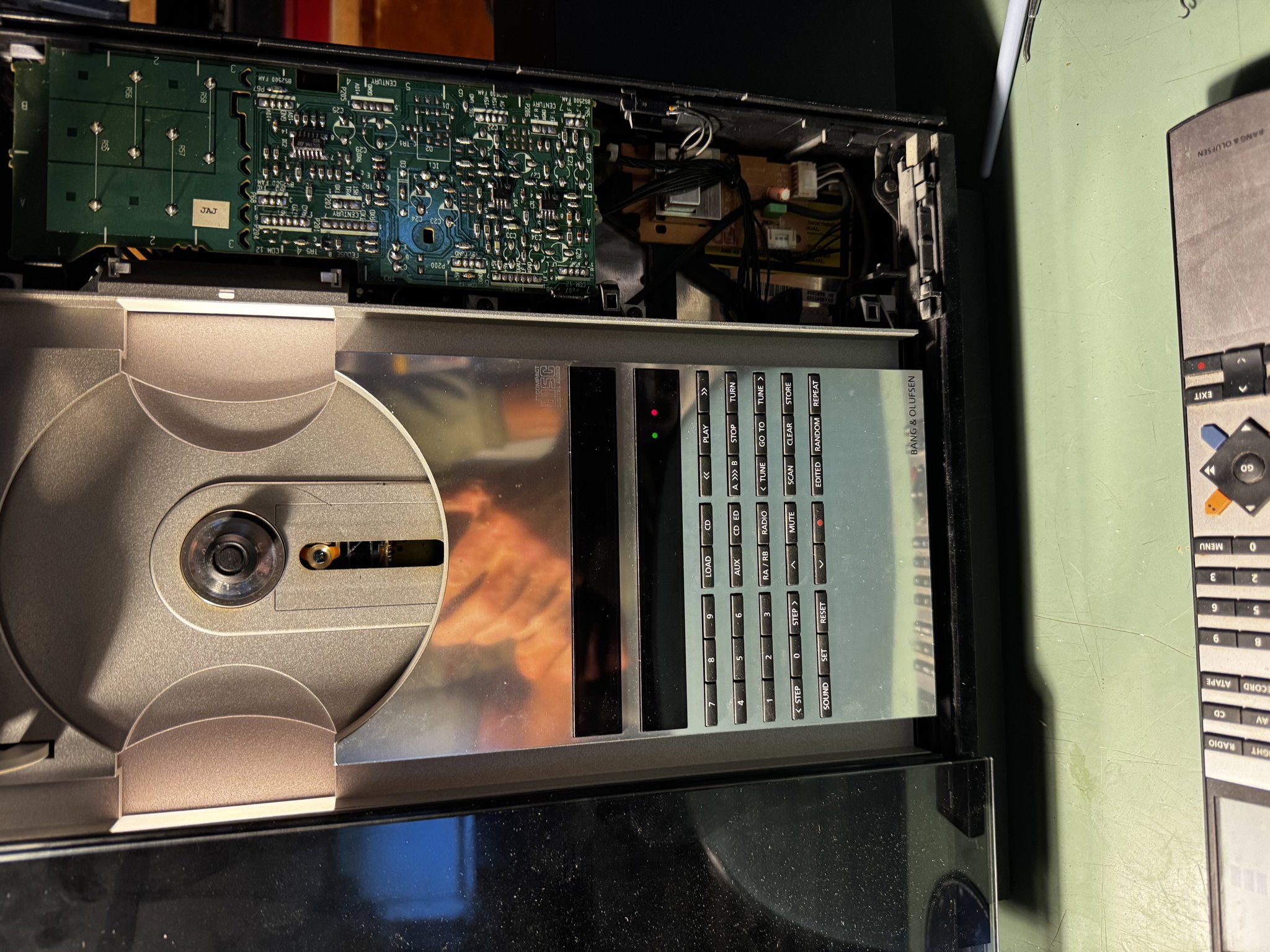

What type of BC2300 do you have? Straight or curved path laser? And what CD module is fitted? Perhaps add some photos.
I would be checking power to the CD module, and the security of any ribbon connectors.
Heee is a pic of the type:
Thanks - the picture is useful.
Have you checked everything that is mentioned in the second of the two threads I posted earlier? This one:
