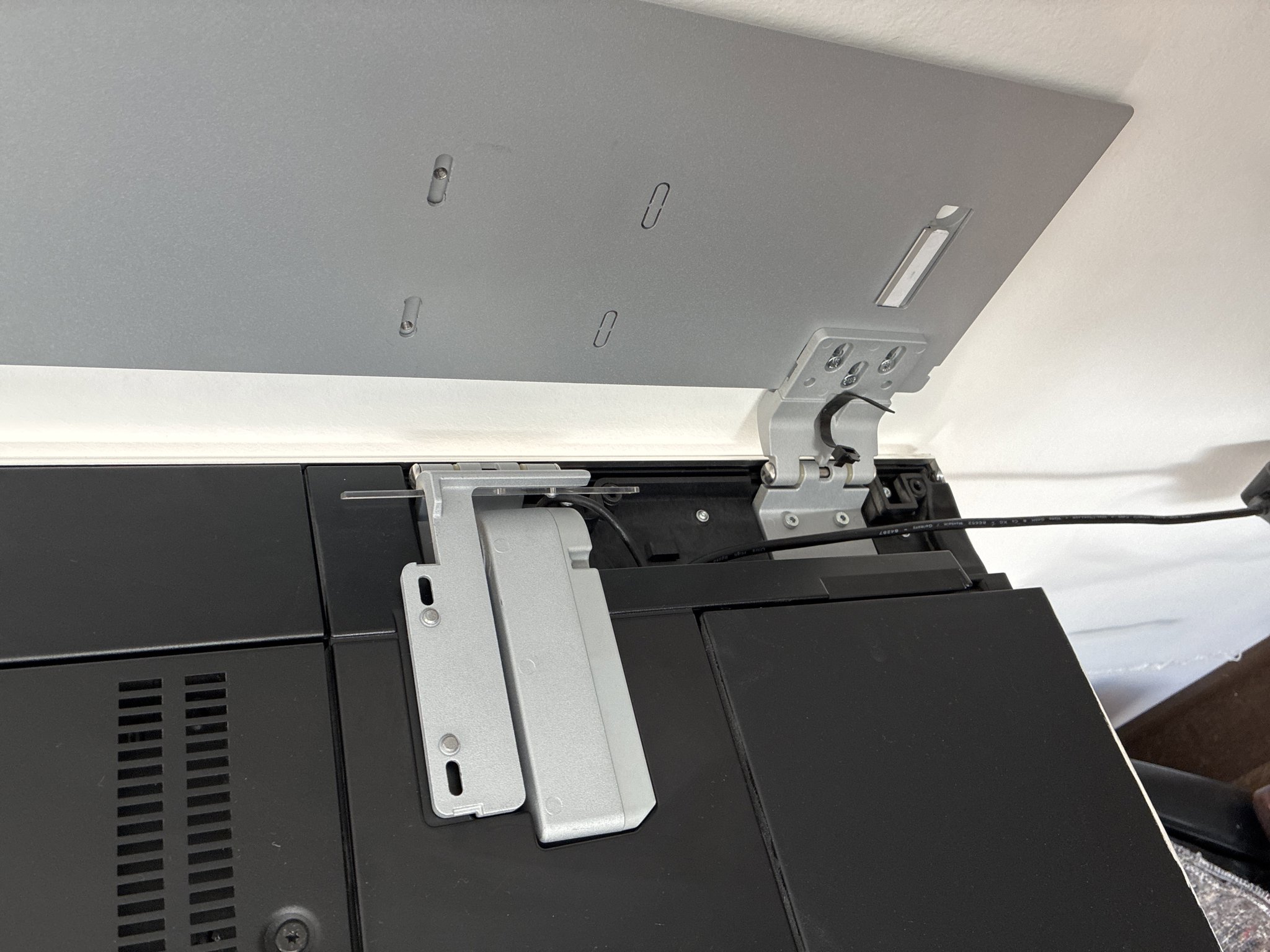

Good morning, I recently acquired a Bang & Olufsen BeoVision 11-46 with a motorized wall bracket. The television works perfectly; however, there is an issue with the wall mount. The motor appears to have moved to its end position and can no longer be controlled using the remote. I have tried to resolve the issue through the settings, but without success. I receive a message prompting me to set the end positions (maximum angle and parallel to the wall), which I enter and which the television confirms. After that, nothing happens—there is no prompt or response to control the motor. As I am new to Bang & Olufsen, I was wondering if there might be something simple I have overlooked or a trick to reactivate the motor. I would appreciate any help. Best regards, Herbert Brantl
Did you fold the TV manually back to its parallel wall position? (The motor makes a ratcheting noise when you do this). Graham
Hi Graham, No, not at all. I bought the TV after it had already been removed from the wall, and the hinge was fixed in its current end position. In my opinion, the motor needs to be activated so the arm can move back toward the wall bracket. That is exactly the issue — I cannot get the motor to respond at all. During my research, there was always a "Transport Lock" mentioned. Any idea, if ever this is activated, how to unlock???
Hi Herbert, I can’t really help further. Presumably the hinge is plugged into its power socket on the TV? Graham
