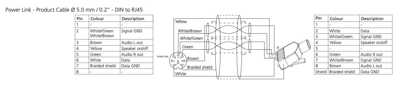

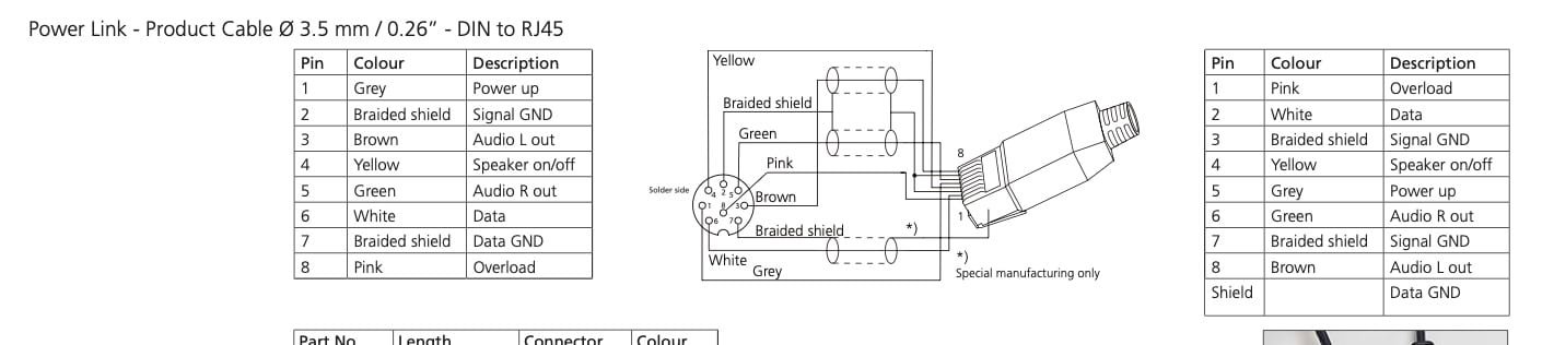

Hat jemand die Pin-Belegung für den RJ45 Stecker zu Powerlink?

Hello Martin,
These are from the BeoLink handbook:
The color scheme depends of course on what type of cable you have.
Hope it helps.
