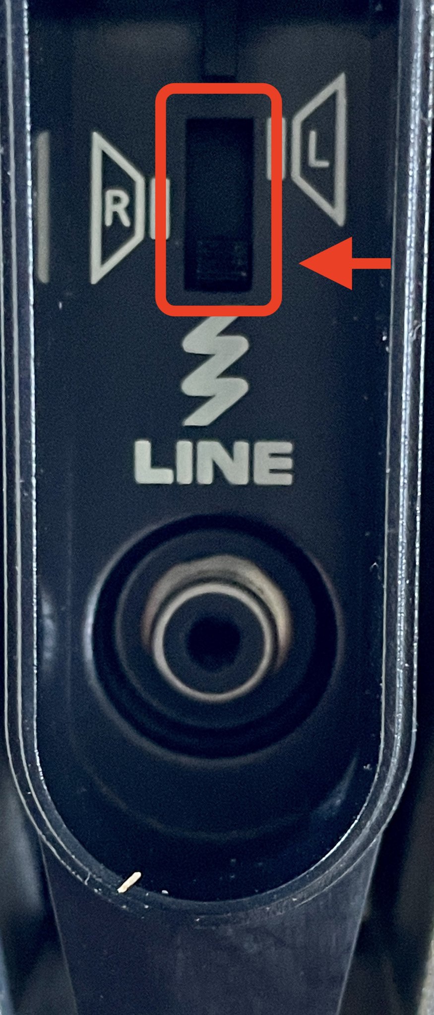

  2. For your tests, did you put the  small switch on the bottom of the BeoLab 8000, to the lower position (LINE - see picture) when using the RCA input: yes/no? (The speaker may not work correctly from the RCA input when the switch is in the PowerLink position)

  4. Also, when the faulty speaker LED is green, do you hear absolutely nothing at all? No hiss from the tweeter, no hum, no clicks from the drivers?
This information will help narrow the fault down considerably.
