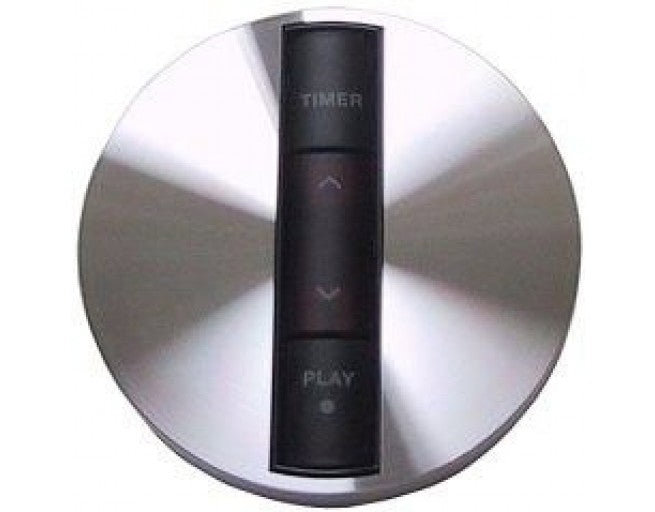

  • Is there an IR eye in the room with the Beolab 4000's? It is most likely a round silver metal puck with some black plastic buttons on /api/files/aec1043fa2eb417697e081a1757d4cb1 If there is this is most likely setup as a link room and the same control issues as mentioned for the Beolab 3500 applies here.
