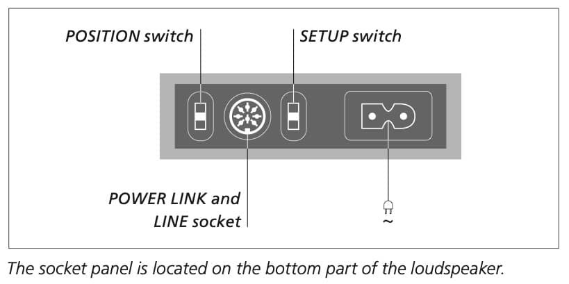

Hello Ryan, good find! Yes you can daisy-chain BL3s (edit: with a splitter), they have (edit) one Powerlink socket each. Direct or daisy-chained should not make a difference. If you set up the 11-46 with the BL3s as front L/R, the TV will act as the centre speaker in a 3.1 surround sound system. Regards, Johan (Thx Beouser 19 - I was too fast on a quick google image search)

Beolab 3 cannot be daisy-chain ! they have only one powerlinksocket
That is not a big deal - you can use a PL-splitter, which basically lets you daisychain one to another. However, if set up with the BV11 they will be placed on either side….so no need for daisychaining. MM

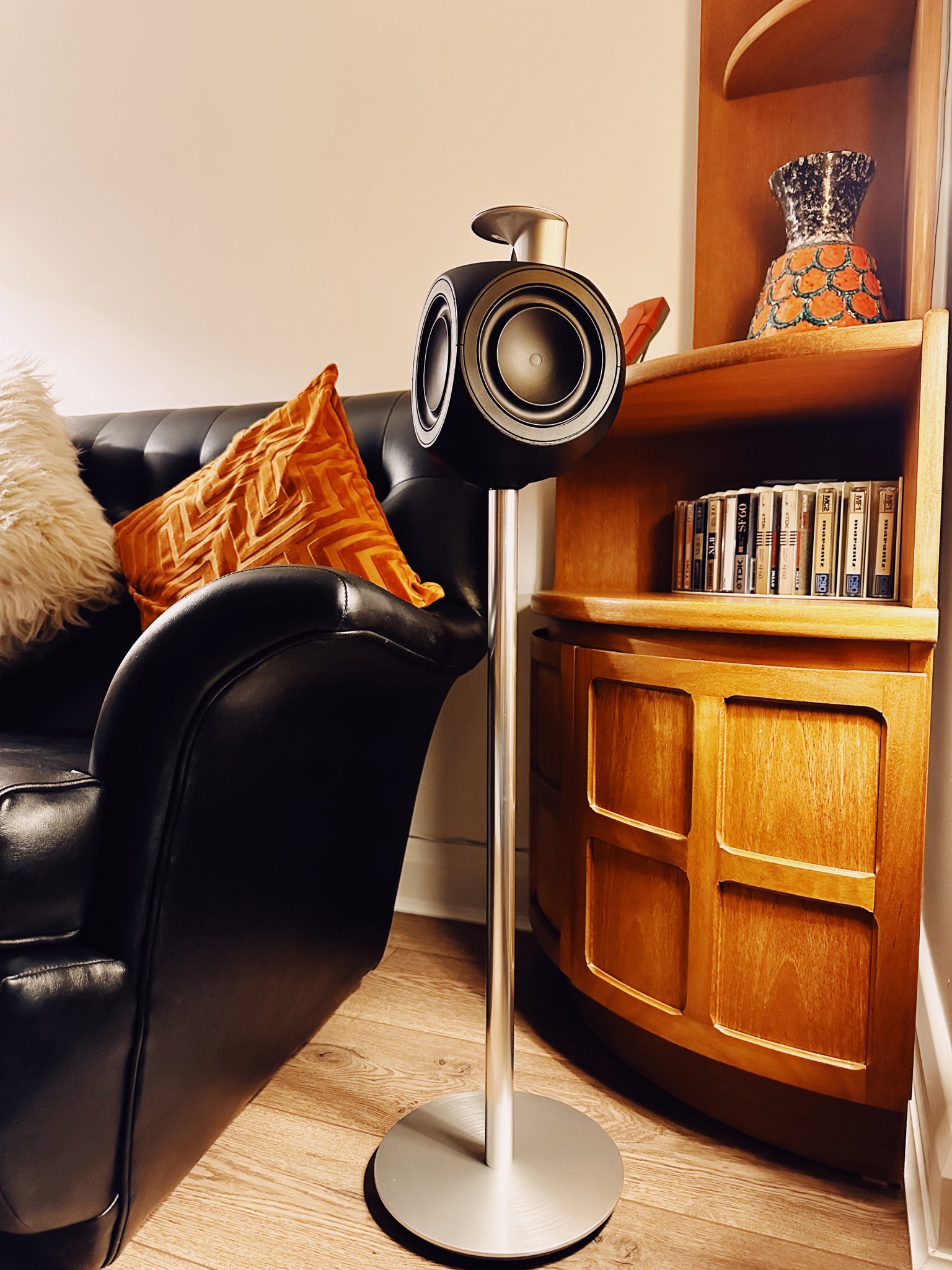

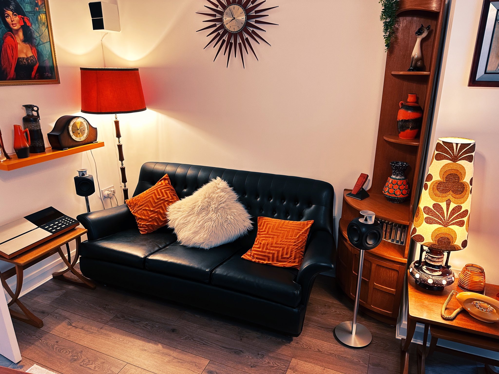

So I collected the speakers yesterday they look great     They came with mains power leads, but no power link cables. I don't know if I have cocked up though. I have bought two 10 meter white MK3 Power cables with the din plugs at each end as I thought it might be convenient to daisy chain them from the Beolab 2 sub as it has two outputs and very slightly closer to them instead of the TV itself.   However, someone elsewhere has advised if its plugged in this way TV > Beolab 2 > Beolab 3 L+R speakers you actually have no control over treble or bass from the TV if they are plugged into a sub instead of the TV directly. So I am not sure if I need to get one of these adapters instead?

Congrats! When connected to a BV, you should definitely connect the BL3’s and the 2 seperately. Otherweise you will not be able to configure the setup correctly. Connecting the 3’s via the 2 is correct, when you connect to a Beomaster/Beosystem/Beosound (i.e. not the BS Theatre) such as a BS3000. There you have no option for setting the distances etc etc. Please consult the userguide of the BV to find explanations of how you connect external speakers. This said - it is possible to do what you have done - but it is certainly not the best way, and nothing that I would recomment. So, yes - you will need adapters Best set each speaker up seperately. MM
A Powerlink connection (one cable) carries two channels. This means that you can use the mentioned adapter for two speakers i.e. your left and right BL3. That must be configured in the sound menu of the BV for the PL socket you use. However, the BL2 needs its own socket to be configured correctly. Meaning that you will also need an adapter for that (a single RJ45 to Din female). After connecting that to a PL socket on the BV that can be configured appropriately. You then end up with a 3.1 setup (the internal speakers must be configured a the center speaker). In case you later on should want to expand, you just need another splitter (like the one mentioned) and - of course - the BL’s configured as surround L/R. All set up you can create Speaker Group - for Movie typically the 3.1 configuration and for Music (radio etc) typically a 2.1 configuration. If you want to dig deeper and learn about the multiple options of the BV11, please read here: https://bangolufsenassistentgohe.blob.core.windows.net/manuals/TELEVISIONS/technical_sound_guide_televisions_2201.pdf MM
