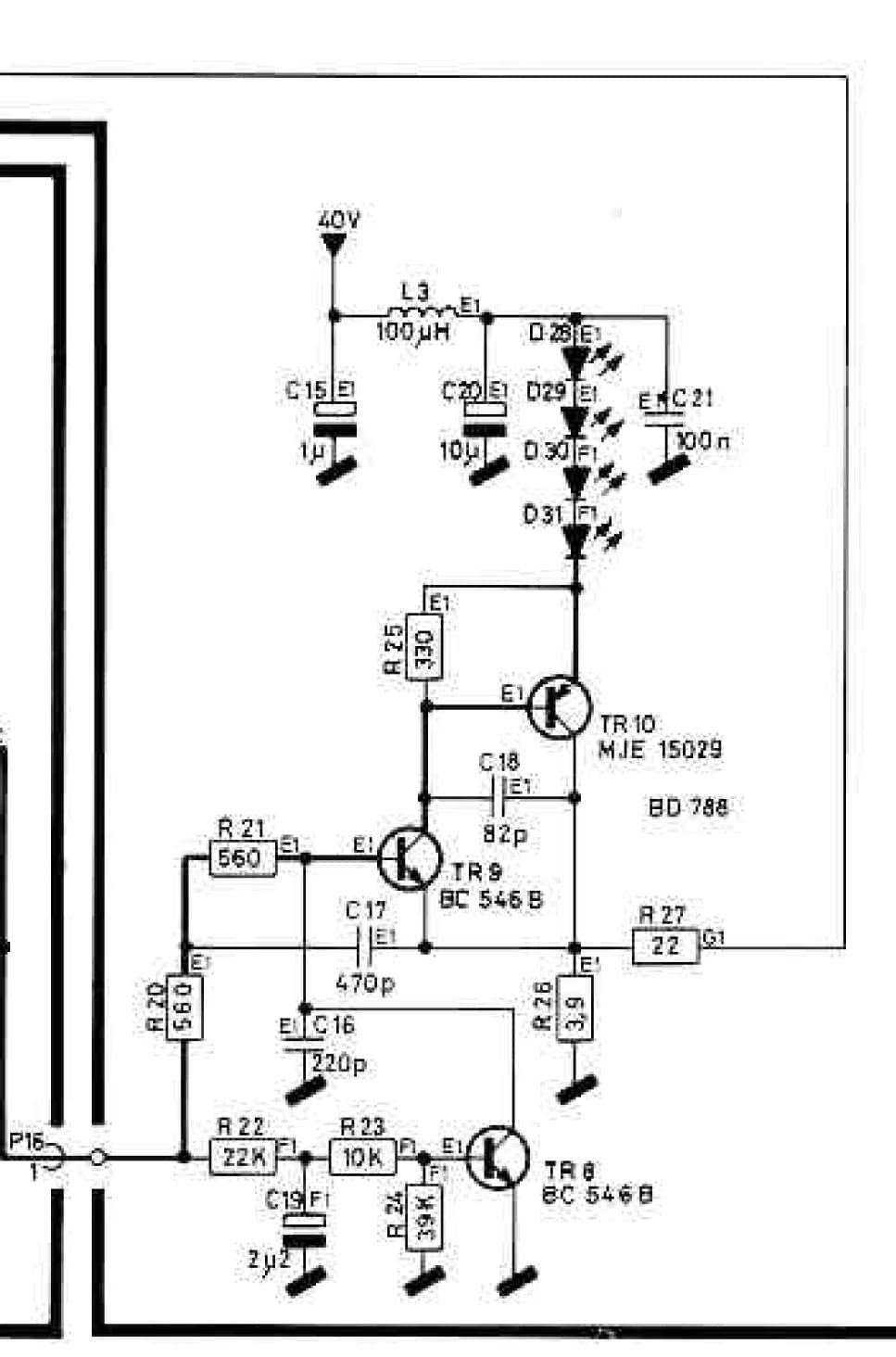

I solved this issue a while back on a Beomaster 4500. Very different setup but the issue was the same: any button press with remote comes out as a buzz through speakers. In my case it was actually the IR transmitter secction causing the buzzing - confirmed by switching to a one-way remote. Perhaps the BM7000 always transmits, even when using a one-way remote. Regardless, I swapped a capacitor in the transmit circuit for a much larger one, and it quieted down the buzz. Perhaps it could be something similar but somewhere in the datalink circuit.

Thanks for guidance to this diodes. On Beomaster 7000 it's 9C20 - 10uf capacitor on the same position like your 5C110. In service manual for 7000 this capacitor is grounded to "signal ground" and maybe this is the case here. I think maybe first to try just to disconnect the minus leed of the capacitor and will try to grounded on the other ground piont with a short wire to see what will be the result. What do you think?
Could be worth a shot, I dont have any feedback as to whether that will work or not. There was an immediate change with replacing the capacitor, and a larger cap produced a more quiet buzz. In my case 470uf took out 90% of the buzz. Your case may be different since its a different model, so you'll have to tinker with the idea
