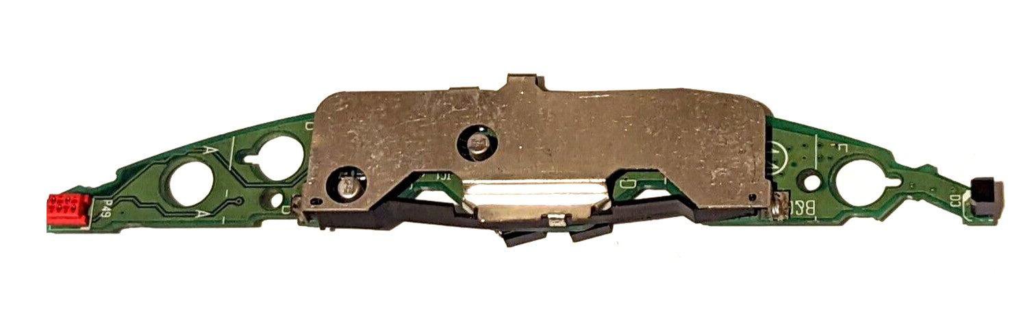

Hi alls, With all the hype around the 9000c, it seems our old units are back in the light again; thank you Recreated Department! Well, mine is a MK2 and has IR troubles. I believe it's "again" a matter of three capacitors. But looking at the three service manuals, MK1, MK2 and MK3 and also to some pictures on the web, I'm unbale to see if the PCB14 is all SMD or may have those capacitors easy to replace. This unit is quite long to dismantle and that one has been a lot of time, I dont want to do it for nothing with the risk of breaking something just to discover the capacitors are beyond my skills to replace. Anyone knows to what looks like the IR PCB in MK2 Beosound 9000? Thanks.

Thanks Madskp, I did it on my Century IR board, yes. But the thing is I got this picture of the PCB 14 on the internet and I can't see a capacitor I can replace on it. I can also find picture that PCB where the caps are easy to locate: That's why I'm asking if anyone knows which PCB is in the MK2 BS9000.

You need to replace these 2 SMD capacitors. The picture shows the wrong way of mounting the black plastic strip in front of it. It needs to be turned 180 degrees.

Thank you Beobuddy, The two pictures seems to show the same PCB. Looking at the red socket they look like shown from the same side and in the first I cant see any capacitor. I dont know much about SMD electronics but What I fear is that it would exist some capacitor so tiny that it would be veru difficult to replace them. Are all smd capacitors look like that little aluminium can or are they some that look like resistors, like very difficult to replace?

Hi alls, Just to confirm that the PCB14 in Beosound 9000 MK2 indeed looks like the picture above. After replacing both 22 microfarad SMD capacitors with regular ones, the IR board calme back to life. Thanks to everyone who helped.
