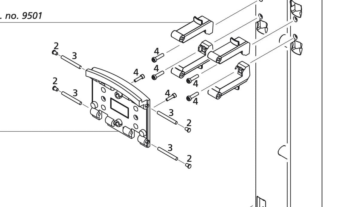

Hi,   anyone have the measurements or type number of the bolts needed to secure a beovision 7-40 to the table stand? Pictured is the wall bracket but idea is the same thanks so much
Attachments (1)
Location: Netherlands
Beocenter 9500, Beogram 9500 mmc4, beolab 9, beolink 7000, beovision 7-40mk5

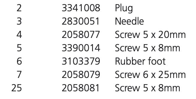

Hello Arthur, The screws to secure the TV to the bracket (4) are M5 x 20:

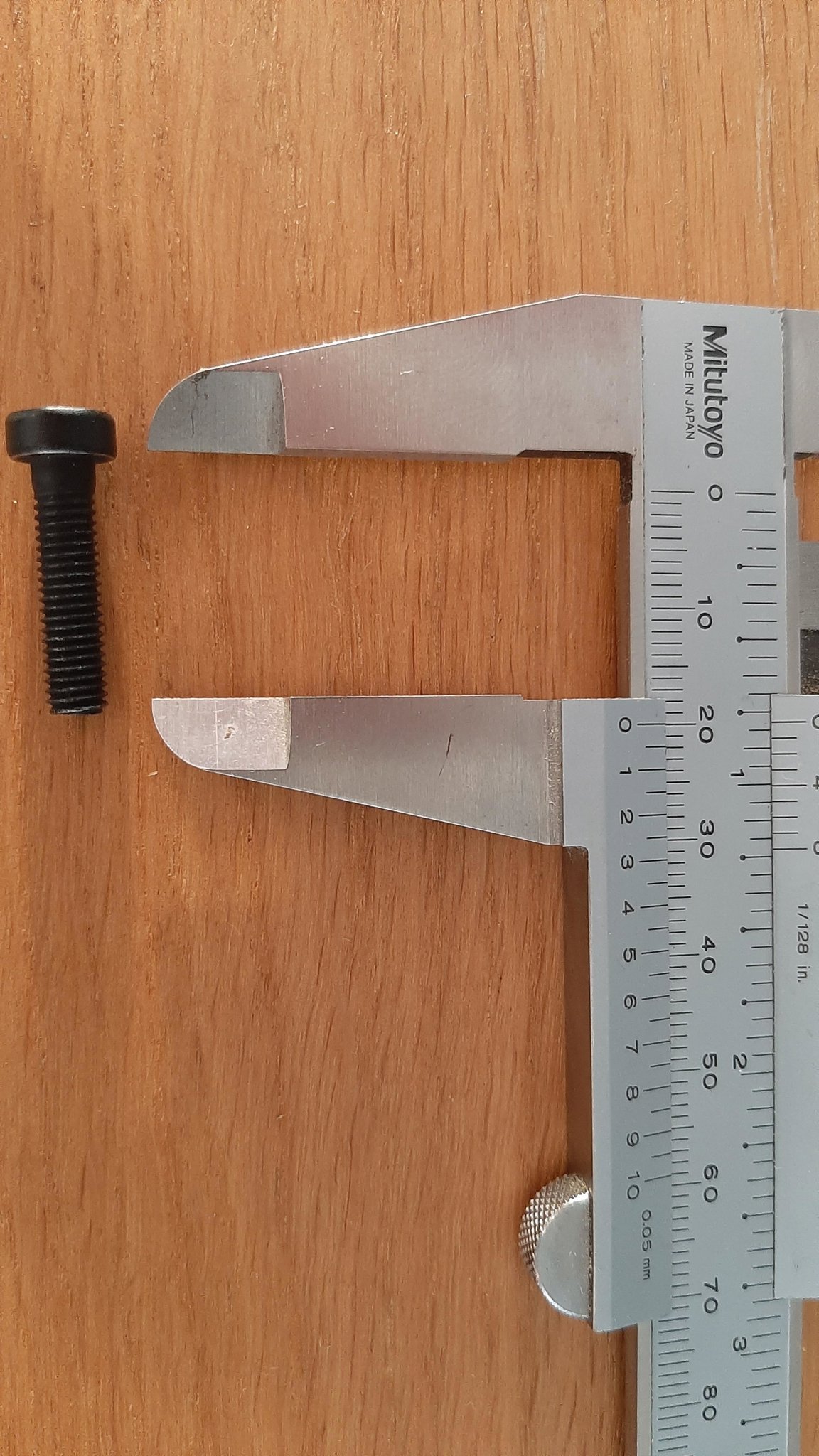

Something like this:
The head diameter is 8.3mm.
J.

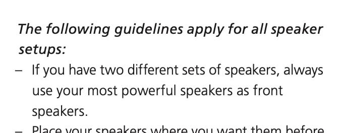

Thanks for the comments guys! You have a suggestion for the settings of the speakers? Suurround L+R or Front L+R?
Hi, The manual says:
But I trust that you can only select surround speakers after you have selected front speakers, and rears after you have selected front + surround.
Don't forget to set volume levels and speaker distances. And enjoy!
