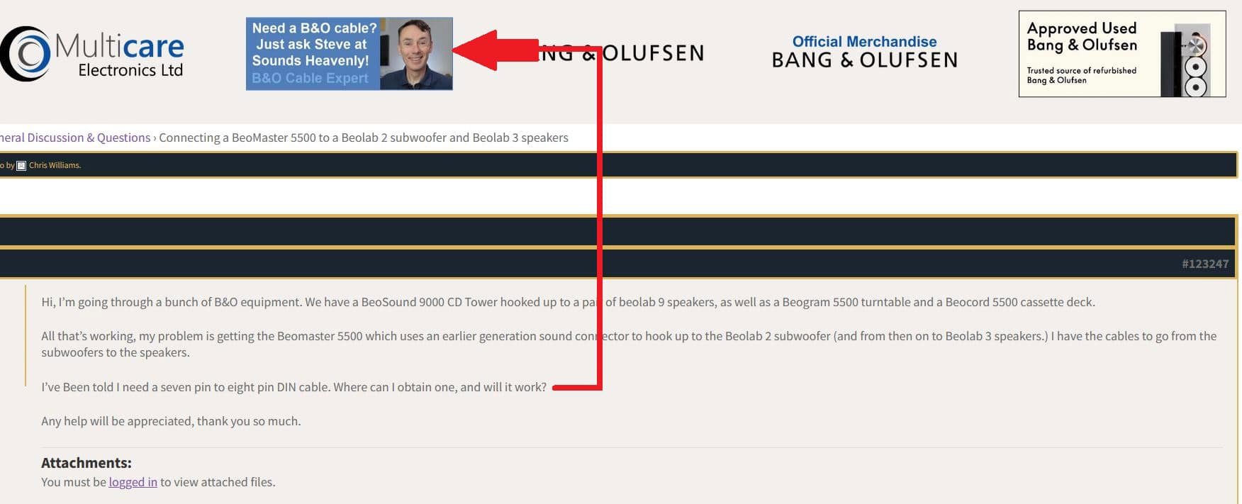

Hi, I'm going through a bunch of B&O equipment. We have a BeoSound 9000 CD Tower hooked up to a pair of beolab 9 speakers, as well as a Beogram 5500 turntable and a Beocord 5500 cassette deck. All that's working, my problem is getting the Beomaster 5500 which uses an earlier generation sound connector to hook up to the Beolab 2 subwoofer (and from then on to Beolab 3 speakers.) I have the cables to go from the subwoofers to the speakers. I've Been told I need a seven pin to eight pin DIN cable. Where can I obtain one, and will it work?
Any help will be appreciated, thank you so much.
I checked his website, and he was shut down for the holiday. Is there a source in the United States, where I'm located? Alternatively, I make most of my own cables, so if someone had a pinout, I could source the DIN connectors locally and make the cable I need.
