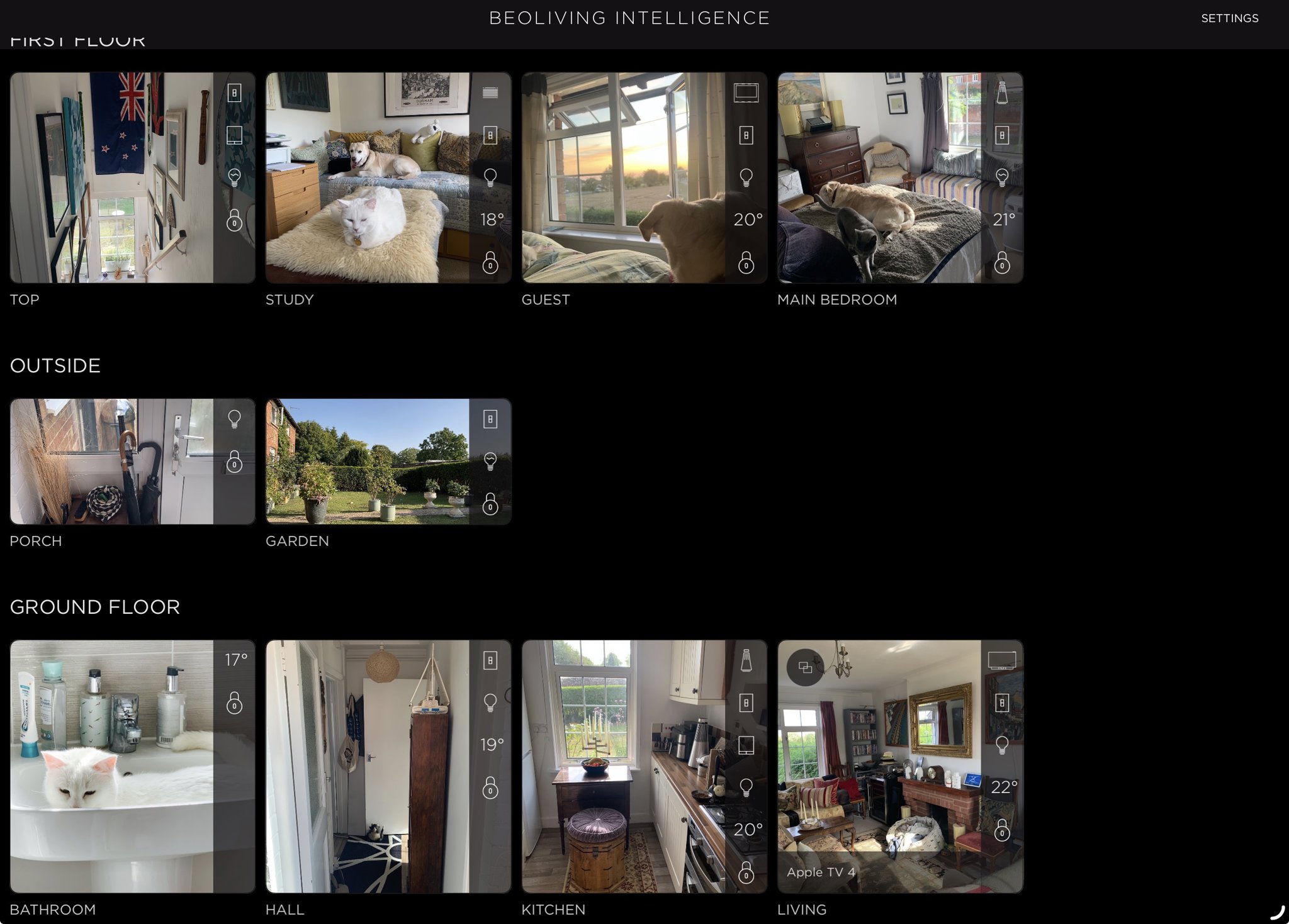

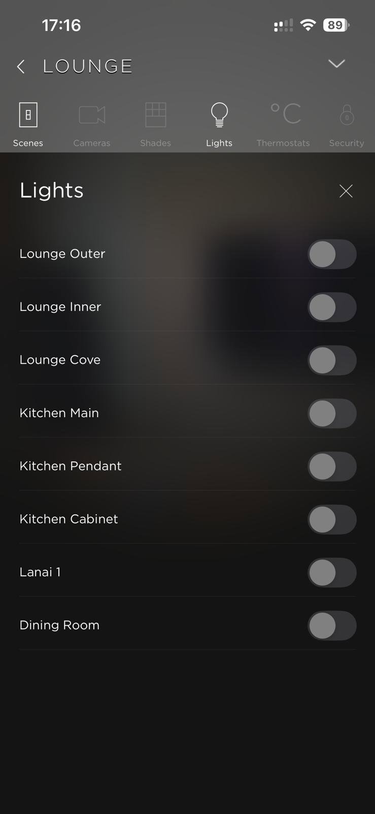

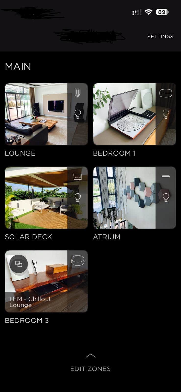

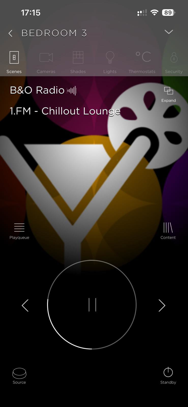

Thanks. Will the Beoliving APP be able to replace the B&O App to select sources and join speakers? If so, any screenshot how such screens in the Beoliving APP look like?
Im not 100% certain. I have still to develop my BLI and do something useful with the Halo.
What I can say is that I can pull all my home automation devices into zones and control curtains and lights directly. I'm sure I can also (with Tuya/Smartlife) pull in existing Tuya scenes (but this wont control B&O) or write a macro to control B&O and Tuya in BLI Pro.
I would say that the BLI is more of a staging/setup device for macros and greater house control. I dont think it is a direct replacement for the BeoApp (though there is no reason to suggest it cant be drilled into and settings extracted). It will control (with the right links/setup), cameras, curtains, security, heating, cooling etc if you are so inclined and talented to setup. Its not obvious on how to do it (like Home Assistant automations I guess), but the links between Tuya, BLI and HA are all there and they seem like they will be able to talk to each other. Finally, as previously indicated like HA, it can augment the Halo better that out of the factory/BeoApp setup is currently.
It depends on what you want to do. If you’re happy with Home Assistant and using your phone you can go with that. I use BLI (pro) and have Home Assistant on a Raspberry Pi that hooks the other items that don’t have BLI native integration, such as Aqara Blinds/Curtains and Tado for the heating. These are then on BLI. I’ve got enough macros in BLI depending on summer/winter/weather that it can operate lights, override heating, work blinds etc, that I never have to think much about the home controls. The only extras I have is with the Halos in the bedrooms and using it for bedroom lights, heating overrides, and getting up and going to bed, macros. The other advantage is using the BLI overlay on the Beovisions (Home Control). Essentially what I’m trying to say is yes I find BLI is useful over other systems if you want to ironically NOT use your phone/BLI app for home control. I’ve also found the macros easy enough to set-up and never went down that road at all with HA, also prefer the app look of BLI over HA. B&O do have an ok training/overview you may want to skim through -
