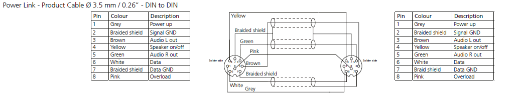

You could try cutting the ML plugs off and soldering 8-PIN DIN connectors, choosing suitable wires so that pins 3, 5 and 6 are shielded, according to the following pin diagram: (Click to open larger) 8-pin PL plugs available here: ) to connect appropriate cables to the ML cable.

I think the first suggestion from Guy is the best idea - If you already have a cable through the wall, as long as it has enough connections and some shielding, then just changing the plugs could be the answer. ML is the cable used to connect different devices together - powerlink is really just audio out and some command functions - the forerunner was MCL which distributed amplified sound and command signals. If you go to the tab at the top labelled Beotech, there are wiring diagrams for Masterlink and Powerlink. The other way is to pul through a powerlink cable attached to the masterlink cable but I suspect that this will be difficult.
