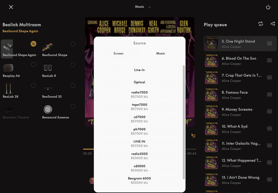

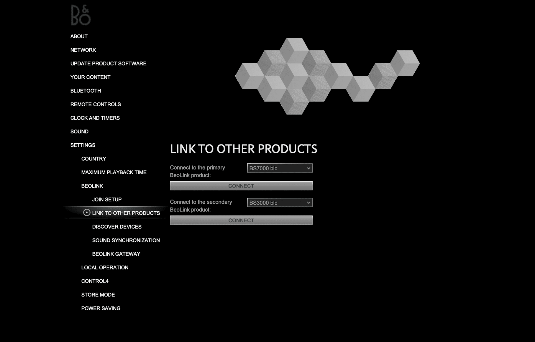

Today I did some work on my NL and noticed that the secondary linked products do work again! I linked Beosystem 7000 and Beosound 3000 to one Beosound Shape. The cd3000, bg6000 (a.aux of the 3000), cd7000, ph7000 & tp7000 are sources off the Shape.
It also works for my original Core. Thought they had stopped updating this.

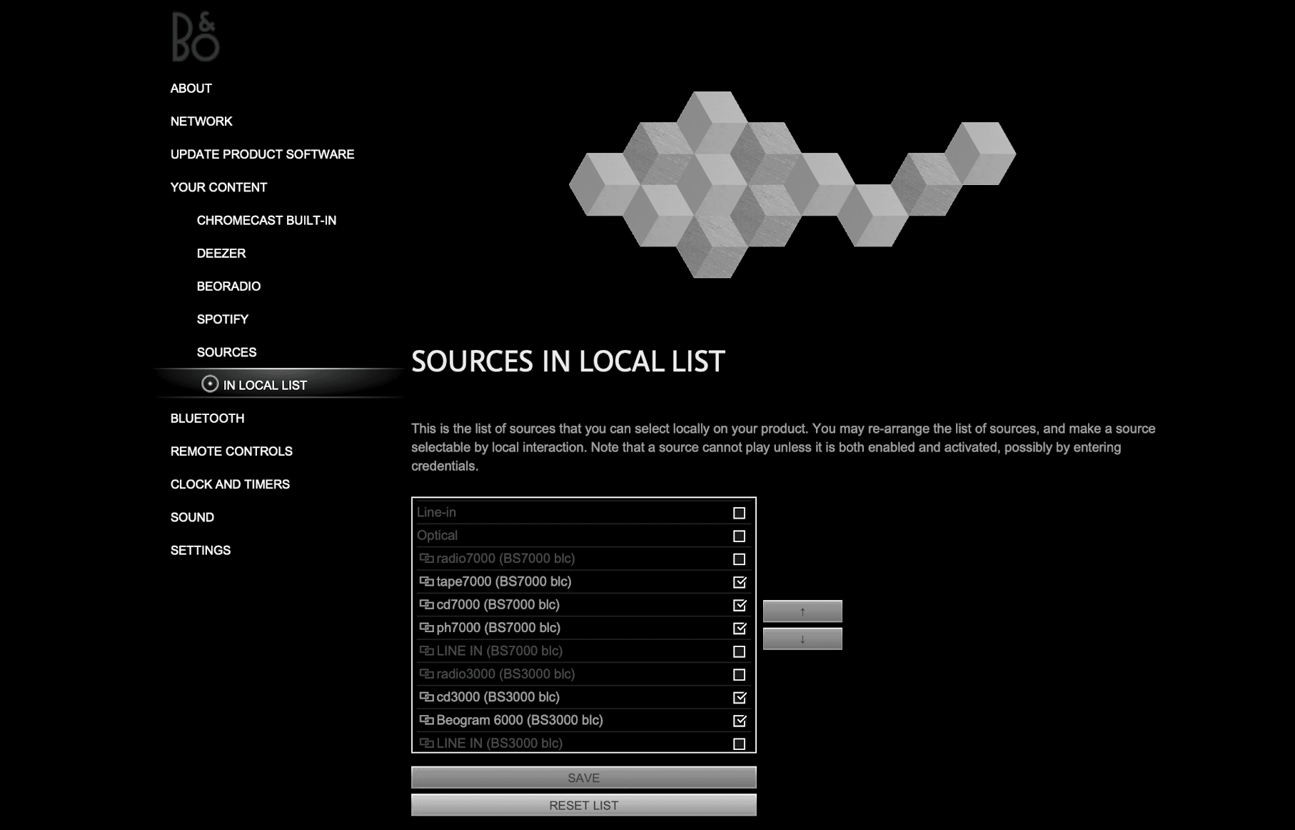

It was the "connect to secondary product" feature that has been broken for quite some time - when b&o radio was introduced to these devices. The drop down option was there, but the sources wouldn't be available.
I noticed that Tidal isn't available in the local sources list on my A9 and is thus missing as a source via the Halo. I can start tidal from the app, and the halo then shows Tidal as playing. Another consequence of this bug is that tidal's not available on my V1 where the core is integrated to it. The BLGW and beoliving app see Tidal as a source on these devices so it must be an issue with the local sources list settings screen. I've raised it as an issue with B&O.

the BS3000 and BS7000 BLC both connected to the same Shape (Beosound Core) as primary and secundary beolink.
