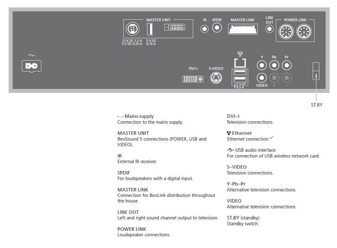

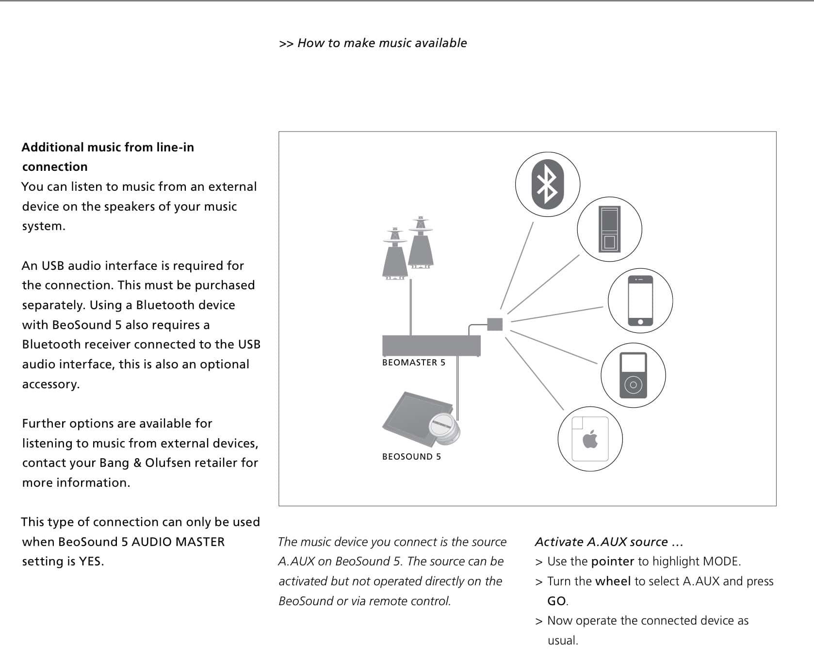

This is how it is described in the User Guide
…and that is how I have done it several times (most people want a turntable connected).
Plug in the Behringer to the USB of the Master 5 - connect L/R of your choosen device (the WiiM)…..
