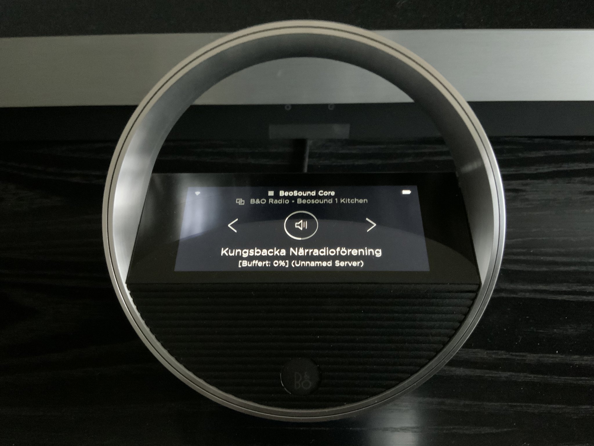

Hi. I have an BeoRemote One (New) there the display has begin to loosen from the upper corner. Is there anybody who can tell if the display is attached with some kind of tape or glue? Is it possible to loosen the whole display and and attache it again with double sided tape or some kind of glue? Very grateful for any kind of tips. Regard ABO

Known issue - please contact your dealer Start at 5:00 https://youtu.be/QTAA96zJKmw MM

Hi. My guarantee is no longer valid so can I use some glue to repair it by my self? Regards ABO.

I’d ask my dealer anyway. This is not supposed to be so, even after garantie. How old is it - has you had any fluid spilled on it or so? Also, you could buy a new insert/inlay and reuse the housing, if you don’t have success with glue. MM
It was buyed from a serious dealer who buy and sells preowned Beo products. This remote was newer used according him. I received it with original package and plastic film on the display. No fluid has never spilled on it, I am very careful with my products. The display started to loosen after 2 days after I received it. ABO

Hi B&O friends. I have just fixed the problem with the loosen display on Beoremote One. It is attached with doublesided thin tape. ABO
