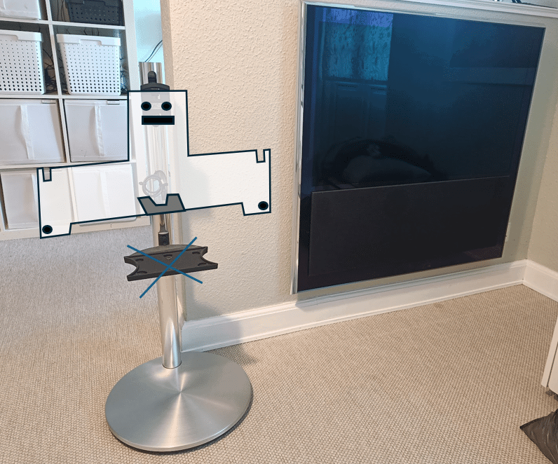

Just an alternative option. If you are a 'handyman' ... it should be possible to convert a BV7-32 stand for the BV10-40. Where I live there are many BV7 stands available and you get them more or less for free (<40£) You can buy a DIN<>8 PIN micro-fit molex cable or solder one and make a plywood adapter plate yourself.

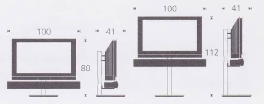

Maybe the lower 4092 fits?
That will be tight (112-80)! Shortening a 4091 sounds safer :-).

Hi, my thinking was not to modify the stand at all. I got a 10-40 hanging on the wall and a BV7-32 stand. I just placed them next to each other to illustrate how I would make the adapter plate. I looks a bit like a ghost :-)  - - but it is Halloween tomorrow - -  so.... :-) At the top you have 2 holes to bolt it to the original bracket. There is a small cut-out for the hinge. Put 2 bolts into the TV and slide it into the two cuts/slots at top. Fasten the bolts and add the additional 2 at the button. The cut-out at the button ensures the ventilation isn't blocked. A small bracket (drawn in grey) determines the tilt as the TV will lean forward by default due to the modified 'balance point'. This will put the TV at the original heigh above the stand-base i.e. approx. 8-10 cm.
Hi Ravsted, hi Beostoked, Indeed things depend a bit on having the 'spider' on the back of the BV10-40 already or not!
I like your friendly ghost image!
J.

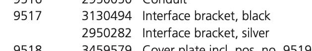

Thanks for all of your inventive solutions, I’m not sure if I could realise any of the adapted designs but I am very grateful for the time you’ve taken to help. out of interest, I know the 10-40 and 10-46 share the same stand but could anyone confirm that the ‘spider’ bracket (good description Tignum) between the tv and stand are also common to both sizes of tv ? all the best and thanks once again!
Attachments (1)
Hello Beostoked, the servicemanual is issued for both 40&46 and there is only one 'interface bracket' that I called spider:
No worries there!
