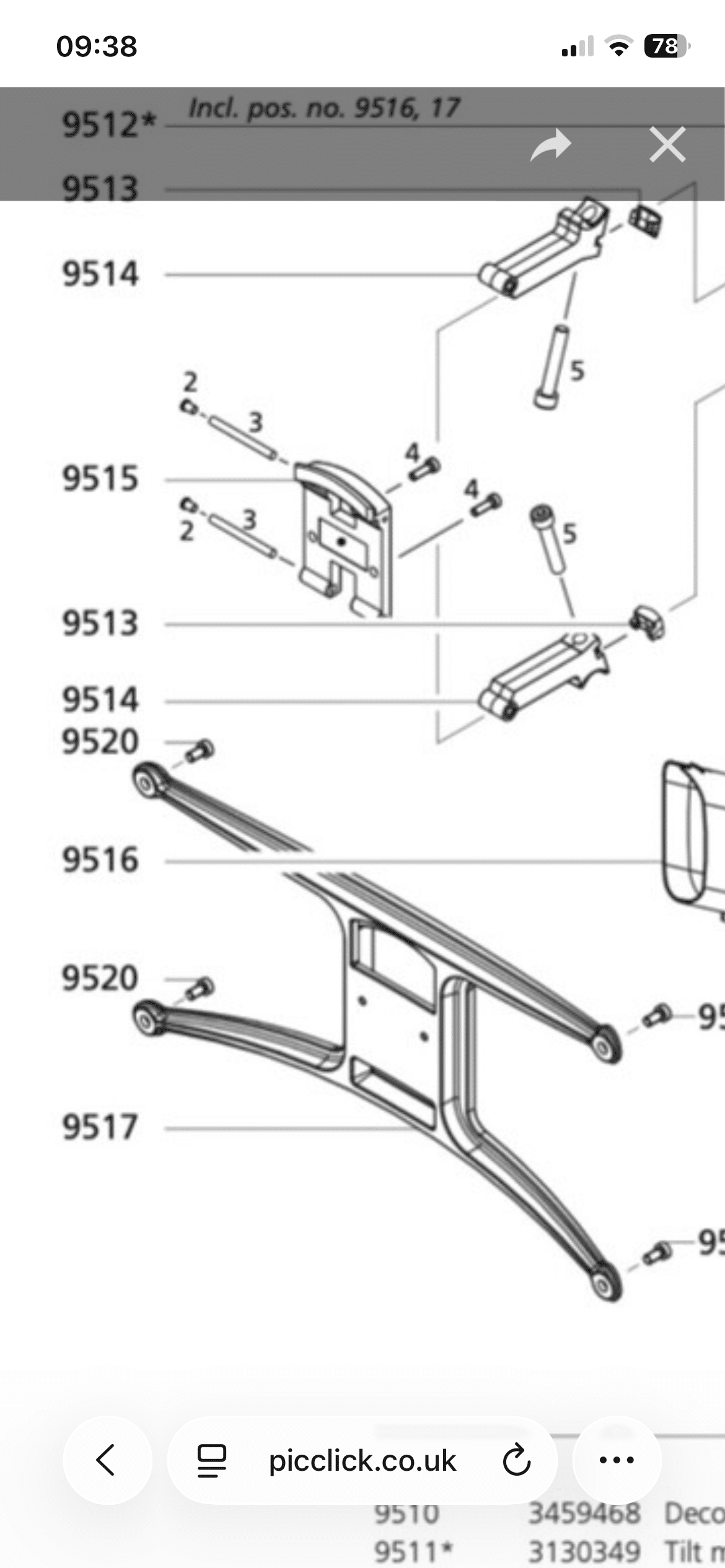

Thanks for all of your inventive solutions, I’m not sure if I could realise any of the adapted designs but I am very grateful for the time you’ve taken to help. out of interest, I know the 10-40 and 10-46 share the same stand but could anyone confirm that the ‘spider’ bracket (good description Tignum) between the tv and stand are also common to both sizes of tv ? all the best and thanks once again!
Attachments (1)
Hello Beostoked, the servicemanual is issued for both 40&46 and there is only one 'interface bracket' that I called spider:
No worries there!
Regards, Johan
