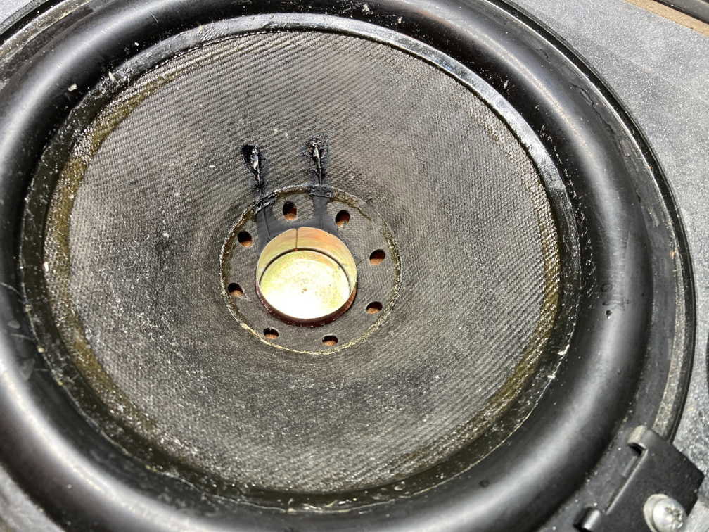

Hello! New to the forum and nice to be here. I’ve just acquired a pair of B&O S45-2 speakers, (paired with a lovely Beomaster 2200), which unfortunately have two non-working bass drivers.  It seems that they've been a victim of the magnets issue which I know is quite common, meaning there is no free movement in the cones at all. I’m assuming there will be damage to the voice coil as a result. One of the drivers does sound very slightly, but only very high frequencies, the other is completely dead.  The other drivers, tweeter and mid range seem to be fine. I'd love to repair the existing drivers, but suspect it may be beyond my abilities. Therefore I'm looking for two S45-2 woofers!  I'd really like to keep it original if at all possible, but realise that might be tricky. Any ideas welcome, Ian

Thank you, I appreciate the advice!  I would really love to keep it original, especially having got lucky with the Beomaster 2200 - think I've caught the B&O bug. So I've tested continuity and it seems like one is good, one is not! Which probably doesn't get me far.  I agree it seems unlikely to find many of the drivers on their own - most likely if there's a non-working S45 out there, this is what might have gone wrong....!  I did find the thread you mean I think, looks like a satisfying process. There is part of me thinking ultimately I may have to find a suitable alternative driver, but not given up yet. Is there any way to find out the TS parameters of the original driver itself? I've put a few photos of the speaker for interest..and one of it's brother too...

Hi, I have a pair of S45-1 (6302) and I needed to service the woofers as well. I found that these woofers are of a non-standard type in the sense that they have a set of leakage holes just inside the dustcap, a kind of "variovent" solution, to make it work in an essentially too small enclosure for a 200mm driver. I an uneducated attempt to "improve" the driver I coated it with acrylic, which sealed the previously air-transparent dustcap. The system was now completely sealed, and the result was terrible, too high fc (85Hz -> 68Hz) and too high Q (0.7 -> 1.1 ). And that was exactly what it sounded like, throttled and bumpy. I had to remove the sealed dustcaps and replace them with new ones of air-transparent textile type. Then it went back to normal. You live and learn. I am not sure if the S45-2 (6312) is the same, but please check it before you try to replace the woofers. BN
